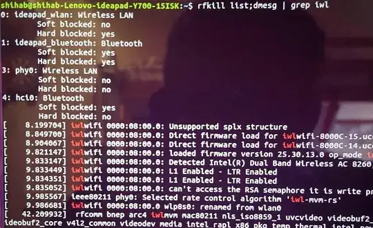

So I was able to successfully install Ubuntu 15.10 However I have run into the error of having no WiFi. The ethernet cable works but it seems that the wifi is not possible to reach. This is my network adapter...i believe
Network controller [0280]: Intel Corporation Wireless 8260 [8086:24f3] (rev 3a)
Subsystem: Intel Corporation Device [8086:1010]
Kernel driver in use: iwiwifi
Pilot6
  • 92,041
su2583
Your wireless adapter is hardware blocked by rfkill, because of a tricky Lenovo UEFI firmware.
This issue has been fixed in upstream kernels, but the fix did not reach Ubuntu yet.
You can fix it by running
sudo tee /etc/modprobe.d/blacklist-ideapad.conf <<< "blacklist ideapad_laptop"
Reboot and enjoy.
When you upgrade to Ubuntu 16.04, remove this config by
sudo rm /etc/modprobe.d/blacklist-ideapad.conf
But likely the fix will reach the Ubuntu 4.2 kernel too.
