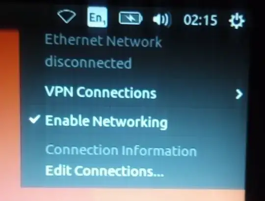

So I then tried installing bcmwl-kernel-source manually, along with the other packages it needed. I did that and rebooted the machine several times, but I still don't see the wifi as an option
The last thing I tried was setting up a new connection using the "edit connections" button from the image above, and set it to what I could see from my other ubuntu machine over wifi, but I still don't see the option to connect through that anywhere.
