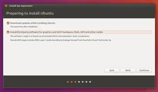

I also ran into same problem. I have same HP probook 450-G3. Solution is to connect to Internet with Ethernet. Open Additional Drivers(comes Pre-installed) from dashboard, check for available drivers and Apply. This should install Wifi drivers compatible with your hardware.
Also while installing ubuntu (for next time) , you should check on installing third-party softwares, that will automatically install wifi drivers as well.
see the pic
