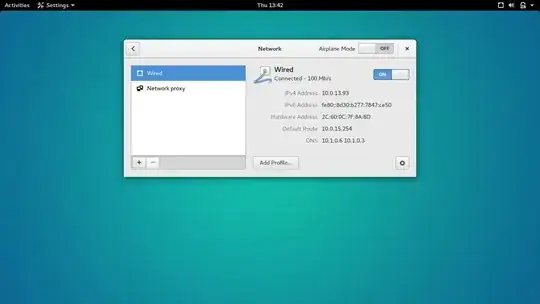

I can't view any wifi networks after upgrading to Ubuntu 16.04 from 14.04. This issue also occurred when trying to upgrade to Ubuntu 15.10. This is what my network window looks like:

Also there is no option for Wifi in the dropdown menu in the top right. The screenshots are from Ubuntu GNOME, but it also doesn't work for standard Ubuntu. How can I enable wifi networks?

modprobe: ERROR: could not insert 'wl': Required key not available
You need to turn off the secure boot.
Secure Boot is a security standard developed by members of the PC industry to help make sure that your PC boots using only software that is trusted by the PC manufacturer
  1. Turn off the secure boot
  2. Remove bcmwl-kernel-source
    sudo apt-get purge bcmwl-kernel-source
  3. Re-install bcmwl-kernel-source and the kernel header:
    sudo apt-get install linux-generic bcmwl-kernel-source
  4. Reboot
