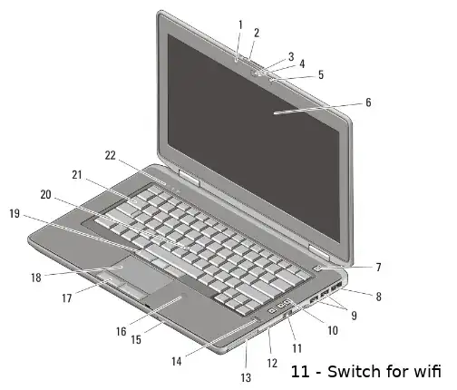

You should also check that the wireless hardware is turned on. See the picture.

The switch for wifi on Dell Latitude E6420:
