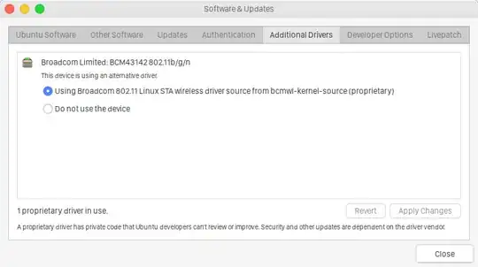

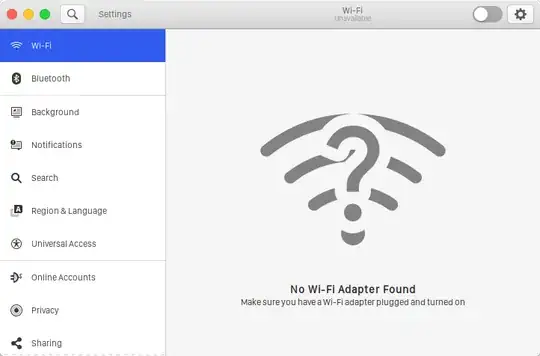

I just removed the Windows partition on my Toshiba Satellite C55, but when I did so I lost the functionality of my Broadcom bcm43142 wifi adapter. It is odd because the OS seems to recognize that the driver exists, yet there is no way actually turn it on. Pictures below:
"Software & Updates" shows that a proprietary driver is in use
"Settings" does not recognize that there is a driver

The broadcom open source driver appears to be unsigned and is thus blocked by the UEFI secure boot process. Try disable secure boot in the bios and try again.
