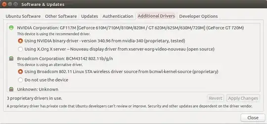

Connect your notebook to UTP network cable and try this:
Check "Additional drivers" and see if driver for broadcom corporation BCM43142 is there and install it - select Using Broadcom 802.11 Linux STA wireless driver source and press Apply Changes.
My screenshot of Aditional drivers
If there is no option in Additional drivers try to install it manually from terminal with following command
apt-get install bcmwl-kernel-source
My output is (using wl driver):
$ lspci -knn | grep Net -A2
07:00.0 Network controller [0280]: Broadcom Corporation BCM43142 802.11b/g/n [14e4:4365] (rev 01)
    Subsystem: Lenovo BCM43142 802.11b/g/n [17aa:0611]
    Kernel driver in use: wl
