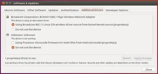

I have an Asus 1015E-DS02
I've tried the solutions here to no avail.
I've also tried the solutions on here and here even though my wifi hasn't worked at all since the upgrade.
I'd also like to note that I upgraded to 16.04 almost immediately after upgrading from 12.04 to 14.04. I'm almost certain that Wi-Fi did work at 14.04.
Is there any significance to it saying that "This device is using an alterate driver?

EDIT: After following this forum I've noticed that lspci -vnn -d 14e4: gives Capabilities: <access denied>. When looking for /var/lib/dkms/broadcom-wl/ as suggested, it did not exist. I don't know what that means but it feels important maybe.
EDIT: The solutions here did not work either.
EDIT: A friend of mine took a look at it and thinks that it might be related to a problem with the UEFI.
First you need to install the correct kernel by
sudo apt install linux-generic
Then remove the wrong driver by
sudo apt purge bcmwl-kernel-source
After a reboot everything should work.
Pilot6
  • 92,041
