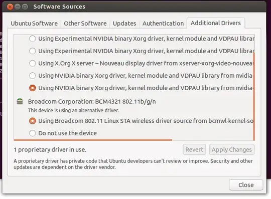

But is this still a problem? The new additional driver tab we now have should fix all the issues: you will be prompted to install the correct driver:
So all the hassle should be avoidable nowadays.
