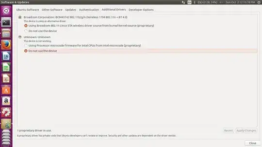

How to remove microcode firmware for intel cpus from intel-microcode because of that i cant use the wifi on my laptop. Pls help for activating wifi. I'm using ubuntu 16.04.

You need to disable Secure Boot in BIOS to get your Wi-Fi working.
Microcode is irrelevant.
