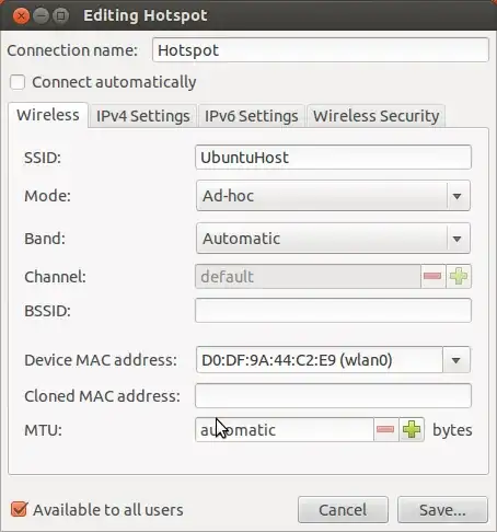

I have Ubuntu 12.04 on a HP 430 notebook and this has a single wired internet connection and I would like to share this with a LG Optimus One with Android 2.3.3. I followed these instructions and created a hotspot as shown below, but UbuntuHost is not visible on the LG Optimus One when I enable the Wifi on it.
To summarize, I want my Laptop with an internet connection to act as a WiFi router and access the internet from other devices (LG Optimus One with Android in this case).
What additional steps have to be done?

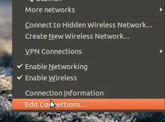

  2. Go all the way down to the Edit Connections option and click on it.
  3. You will appear on the Wired Tab. Each Wired connection is by default related to each Ethernet Wired NIC card you have. For example if you have 2 Wired NICs you will see 2 options here. In the image below you see one since this is a Laptop and they normally have one. Select the Wired connection you wish to edit which should be the one connected to your LAN and not the one that is receiving the Internet connection. Double click on it or select the EDIT button.

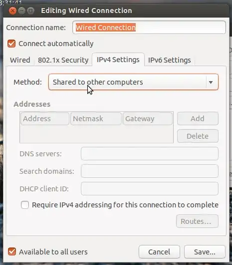

  4. You will appear on the Wired Tab (Again). This time, go to the IPv4 Settings if you are using IPv4 or IPv6 if you are using that one. On the Method option select Share to Other Computers. Now SAVE. You are done.
This will do all the stuff that was normally done 6 or 7 years ago with all the terminal commands and iptable stuff.
Now just connect the 2 computers and you are done.
NOTE: If both computers have a Wired Gigabit Ethernet NIC then you can actually connect them directly since most 1000BASE-T have automatic MDI/MDI-X. If not just connect them to your switch, router, hub, whatever and that is all.

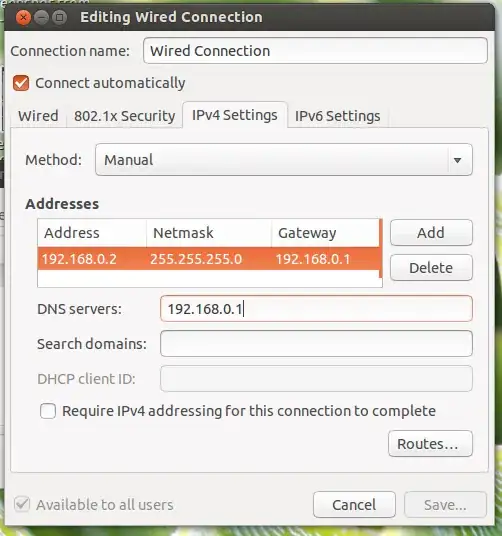

  3. You will appear on the Wired Tab. Each Wired connection is by default related to each Ethernet Wired NIC card you have. For example if you have 2 Wired NICs you will see 2 options here. In the image below you see one since this is a Laptop and they normally have one. Select the Wired connection you wish to edit and double click on it or select the EDIT button.

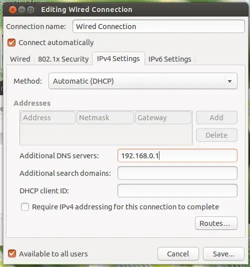

  4. You will appear on the Wired Tab (Again). This time, go to the IPv4 Settings if you are using IPv4 or IPv6 if you are using that one. On the Method option select Manual. The options in Addresses will be editable now. Add the IP you want, the Mask you need and the IP of the PC that is sharing the connection. In this case I said that the IP of the Client PC will be 192.168.0.2, the Mask is 255.255.255.0 to imply that is a Class C (LAN) network and 192.168.0.1 to mention that the computer sharing the connection has the IP 192.168.0.1 with it. Additionally add the same IP of the computer sharing the connection to the DNS Servers (As shown in the image).
You can also (Depending on the network setup) select instead of Manual, select Automatic and just put the IP of the computer sharing the Internet in the DNS Servers section.
Note that this depends on the network setup. For example if you have both PCs connected to a switch or router, the switch/router will take care of the Client, so you only need to setup the PC Sharing Internet and just connect both to the switch/router. If by chance you are connecting the PCs directly together then it is better to do the additional setup of the Client.
In most cases, you will not need to setup the client, just connect to the network and done. Ubuntu will take care of everything. I just added the Client part for specific cases where problems might arise.

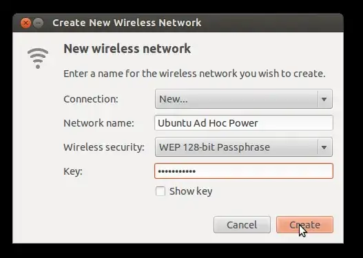

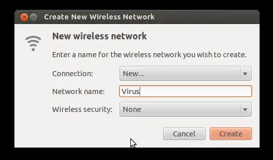

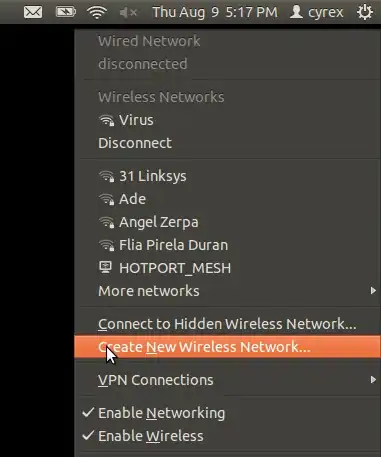

Step 1 - Go to Network Manager and select Create New Wireless Network..
Note that there are other ways, terminal and GUI like, that can also do the job, but this is the easiest and fastest way possible (Even faster and easier than doing it in Windows XP or Windows 7). Also know that I am assuming you are receiving Internet through another network card (Wired or Wireless) and you want to share this Internet connection wirelessly.

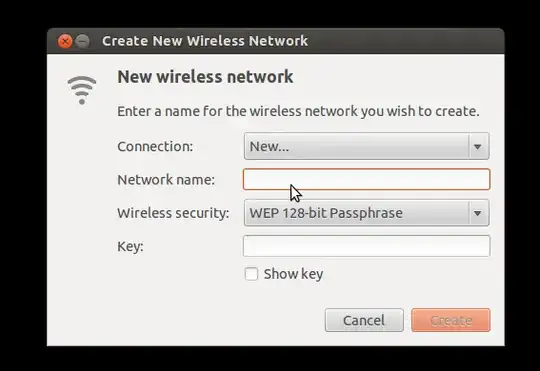

Step 2 - Type name of SSID (The name that other devices will see when looking for the hotspot)
Step 3 - As you can see here I put as the SSID name "Ubuntu Ad Hoc Power" and it has an encryption of WEP. The encryption type depends on the network card. Some cards do no support Ad-hoc with WEP, others with WPA, and others with any security whatsoever. After setting the SSID name and security just click create.
Step 4 - For cases where you will share internet with somebody close to you on the same room, I normally just share the device with no security. Easier for them to connect. Of course do not do this in a party or in an office full of wireless vampires.
Step 5 - When a shared connection is created, the next time you try to share it, it will appear in a connection list, saving you the trouble of naming the connection and setting security.

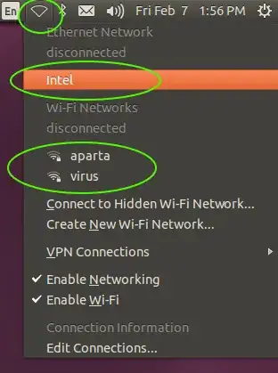

Connecting to a Wired or Wireless Device
Take a look at the image below:
If you click on the Network icon (The green circle at the top) it will drop a menu where you can see all the devices (Wired Connections and Wireless Connections) that you can use to connect. By clicking on them, they will automatically connect to the desire network. In the case of having a Wireless card and have not yet installed the drivers (In the case you need drivers for them), you can visit one of the following links that provide the steps needed to correctly install any Wireless card:

Assuming you followed the instructions fully, you need to "connect" to the wifi network just set up.
  1. Click on the network icon
  2. Select "Connect to hidden wireless network"
  3. Select "UbuntuHost"
  4. Connect
