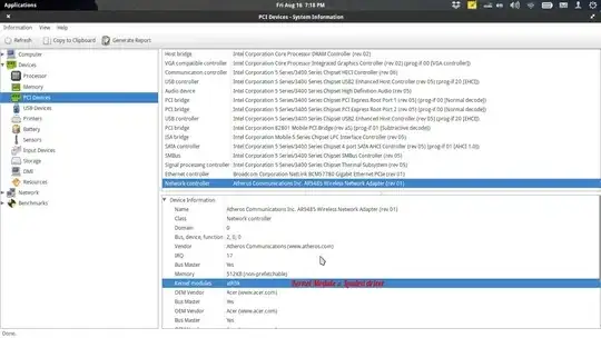

The following method includes the installation of additional software, which name is hardinfo.
You can search and install hardinfo, from USC
or
from terminal (CTRL+ALT+T) apply the following command
sudo apt-get install -y hardinfo
Locate hardinfo from Dash (by writing: hardinfo), open it and goto PCI Devices if your Wireless adapter is an integrated PCI device.
Next to Kernel modules is the current loaded driver of the specified Wireless adapter. In example picture is ath9k
If your Wireless adapter is a USB device, then goto the corresponding entry on the left list under Devices.
