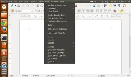

I have been looking to install spell checkers on LibreOffice but I could not find any stand alone Grammar checkers for LibreOffice.
Does anyone know any Grammar checker, like Grammarly, for Ubuntu?
There was a solution posted on Grammar checking program for LibreOffice but that required Java to be installed.
I am looking for a Grammar checker that does not need additional features installed.

Showing spelling and grammarYes
sudo apt install libreoffice-lightproof-en
See: https://packages.ubuntu.com/groovy/libreoffice-lightproof-en
Lightproof grammar checker for LibreOffice (English)
And: https://extensions.libreoffice.org/extensions/lightproof-editor
And Grammar checking program for LibreOffice
