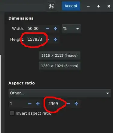

Edit: corrected a typo Ubuntu 20.04.2 changed into 20.04.3 Edit 2: I have uninstalled and installed gthumb 3.8. Edit 3: A bug report has been filed now as well
EDIT 4: I managed to take a screenshot just before Gthumb vanishes(crashes) , just after clicking 'resize'
Gthumb screenshot just before crashing...
As you can see the 'height' of the picture has absurd size (157933 pix.) and the aspect ratio is accordingly.... I don't know what comes first, the aspect ratio followed by calculated size or vice-versa.
QUESTION: I would like to know where Gthumb stores its preferences to see if there is a preference saved previously that causes this absurd aspect ratio for example
