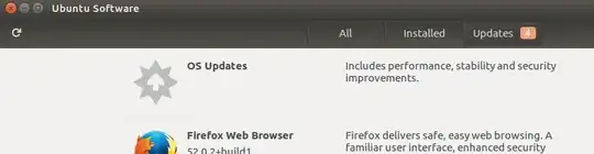

After more investigation (read: blind clicking), I discovered that clicking the refresh icon on the Updates tab actually seemed to refresh the Installed tab as well (even though the refresh icon is not available on the Installed tab). After this, Solitaire stopped showing up.
Screen shot of Ubuntu Software showing refresh icon in upper left corner.
By "refresh icon", I mean the circular arrow in the upper left corner.
