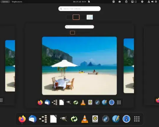

Using Ubuntu in French, I updated to 22.04 yesterday, August 17th and it seems to be incorrect after re-boot. The dock is at the bottom about 1 inch height, I want the dock on the left.

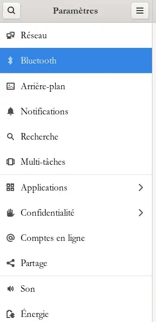

The dock position is normally available in the settings. However, Appearance is missing from the settings list.
Screen dock at bottomEnglish settingsFrench settings

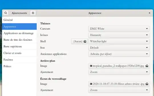

Gnome tweak

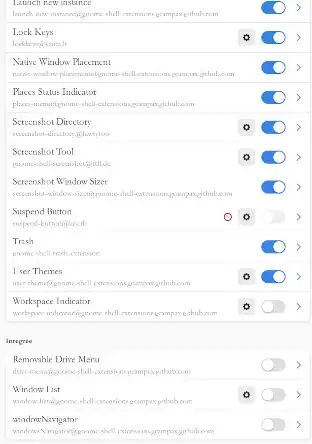

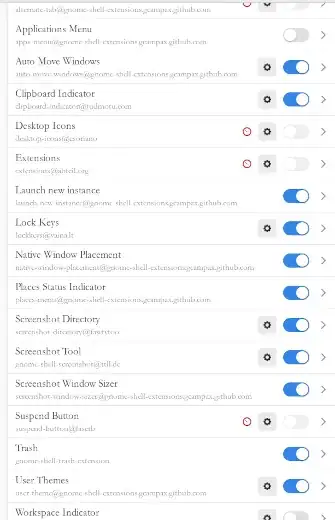

Extensions Manager 1
Extensions Manager 2

But Appearance and Extensions missing Appearance will be in Settings only with Ubuntu Desktop not with Gnome Desktop For Extensions have to use Gnome Extensions via Internet with Firefox but not Firefox from Snap (You have to install Google Chrome to get Gnome extensions) Plus you could install Extensions Manager
