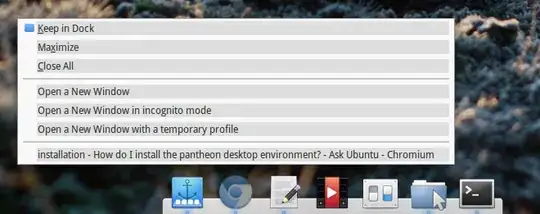

I have this problem about all menus after install Pantheon, I don't have any idea how to fix it. Please help me i'm pretty new to this thing.
I know it has to do with the theme or something.

I found a temporary fix for this.
I logged in to Unity and purged all of Pantheon with
sudo apt-get purge elementary-desktop plank midori
and then ran
sudo apt-get autoremove
I then changed Unity's theme to Adwaita and reinstalled Pantheon with
sudo apt-get install elementary-desktop plank midori
On logging into Pantheon again the menus look just fine.
I don't like the rest of Adwaita though, so I will probably remove Pantheon until this bug is fixed.
