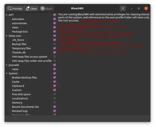

Im using ubuntu 20.04. I was playing with Wine trying to run a certain game (but failed). i tried my best to clean my system up by uninstalling all the apt-get i did, and undoing all the the PPA's.
When I was done, I wanted to run BleachBit, but its now showing an error.
Can someone help me out.
Error when checking for updates:
Traceback (most recent call last):
  File "/usr/share/bleachbit/bleachbit/GUI.py", line 1160, in check_online_updates
    updates = Update.check_updates(options.get('check_beta'),
  File "/usr/share/bleachbit/bleachbit/Update.py", line 155, in check_updates
    opener.addheaders = [('User-Agent', user_agent())]
  File "/usr/share/bleachbit/bleachbit/Update.py", line 87, in user_agent
    dist = platform.dist()
AttributeError: module 'platform' has no attribute 'dist'
Edit:
I've uninstalled and reinstalled BleachBit, but that didnt help.

This was fixed a year ago as issue 819 for release BleachBit 4.0.0, but Ubuntu has a "no rolling release policy," so Ubuntu 20.04 will always have BleachBit 3.9.0 beta.
Please download the latest BleachBit (currently 4.4.0) from the official site. I recommend always using latest version on this site.
