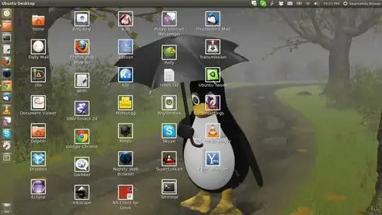

I am having a problem where there is a white square that is visible across every icon. I have attached a snapshot to show the problem.
This problem arose while I was using Gnome Shell and the Faience theme. I am using 12.10, and have tried resetting the desktop to default unity and gnome 3 settings but it did not help.

This seems a bug with the latest nautilus 3.6.3 update.

I also got this when using a recent daily build CD image of Ubuntu 13.04 (no changes, just the default), so this is probably a bug in a new version of Nautilus, as user106593 said.
