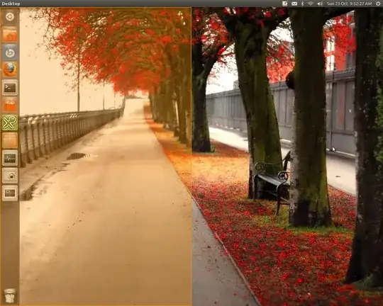

Came to computer, screen was locked, and orange glow (as though I had dragged a window to far left of screen, and it was showing me a preview of where it would snap to) was over left half of screen before I even logged back in, and I was on a clean desktop, with no windows open. It would not go away, and even after I unlocked screen, and it remained on desktop, and even in Expo view (covered whole left side of expo view - two desktops). Finally disappeared after second screen shot.
Screenshot

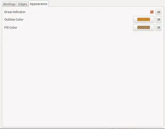

Navigate to Window Management -> Grid.
You could either disable Grid entirely by unchecking the box on the left side,
Grid checkbox
Or you might try going to the "Appearance" tab and unchecking "Draw Indicator": Indicator checkbox
I'm not sure if that will work, but it might give you a workaround...
Hope it helps!
