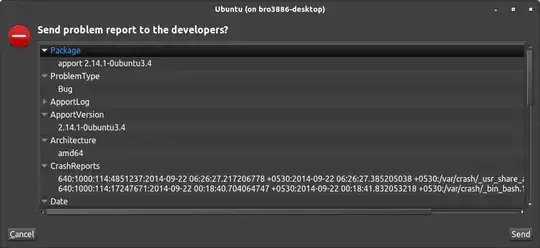

I got this when I tried: enter image description here
(I didn't submit.)
