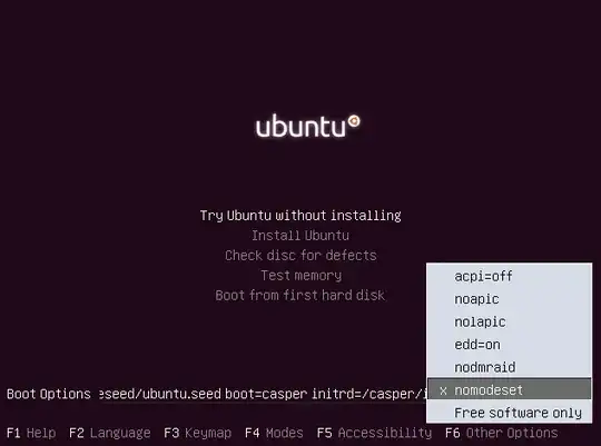

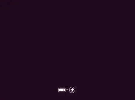

Maybe first you have to hit ESC at the welcome screen(see picture attached), then select your language, then you get the "Try Ubuntu.." screen previously mentioned by Web-E..
After boot from liveCD, In start menu[Try ubuntu/ install ubuntu/ etc] press F6 then select nomodeset. press ESC. Now select install ubuntu.
Also disconnect internet while installing. enter image description here
