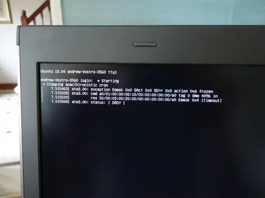

I followed the Ubuntu_Raring_Installation_Guide on a fresh install (packages up to date). The installation seems to go fine. But when I reboot this happens.

Only seen this error once, after second install I didn't get it just boots saying * startingand nothing else. enter image description here
Is this a bug cause by me? or Ubuntu or AMD? Where do I point the finger?
How do I construct a useful bug report for this issue?

Post the information you have here (https://answers.launchpad.net/ubuntu/+question/231272) and the Xorg/Xserver logs on the bug report form that can be found here https://launchpad.net/xorg. Include the kernel and Xubuntu version as well as your hardware information (graphics card, processor, etc.). If the Xorg developers need any other information, they will ask. You may also consider reporting the bug to the Xubuntu developers (https://launchpad.net/xubuntu-desktop) if the Xorg developers are not sure about the issue.
This link may help you - How do I report a bug?.
