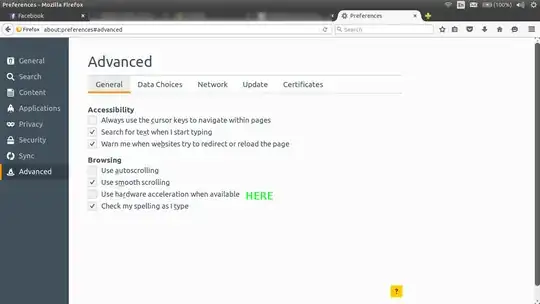

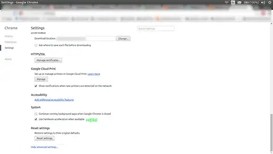

Disable HW acceleration in Firefox and Chrome/Chromium. Today's Google-Chrome update fixed the issue for me but before that, disabling the hardware acceleration was what fixed the problem.
