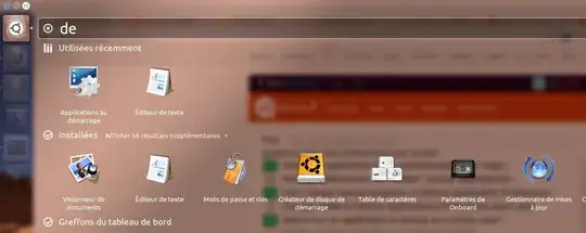

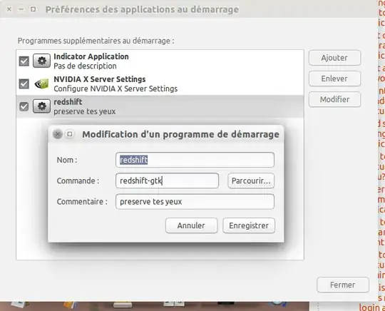

I run "startup manager" : enter image description here
and I have add an entry :
And when I restart my computer, redshift does not start when I start my computer
