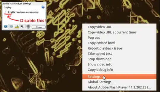

Fix for stopping video AND blue videos on youtube together
Turn off hardware acceleration in adobe flash plugin
On another system I had this exact same problem with the additional quirk that all videos where bluish. Turning of hardware acceleration as worked on one of the systems that had this problem. For some weird reason I could do it in youtube fullscreen only and it didn't work until the on the second right-click attempt.
Flash is only feeling blue
If you have the bluish video bug only, i.e. without the stopping video issue then take a look at this answer: Flash video appears blue.
