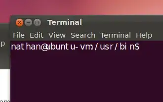

I installed Oneiric as a guest OS in VirtualBox using the Mini CD. I installed the ubuntu-desktop package and everything seems to work fine - well, except for a font issue with the terminal:
As you can see, some of the letters overlap and it's difficult to read. I checked the settings and it the checkbox "Use the system fixed width font" is checked with "Monospace | 12" selected underneath it.
Edit: running the commands mentioned in the comments:
$ fc-match "Monospace"
DejaVuSansMono.ttf: "DejaVu Sans Mono" "Book"
$ gconftool --get /desktop/gnome/interface/monospace_font_name
Monospace 10
$ debsums ttf-dejavu-core

Turns out the ttf-ubuntu-font-family Install ttf-ubuntu-font-family package somehow didn't get installed. Immediately after installing that package, the terminal font switched to the Ubuntu Monospace font and everything was readable again.

Had the same problem. This may be related. Bug #1166125
Removing package pango-graphite fixed the problem for me:
sudo apt-get purge pango-graphite
