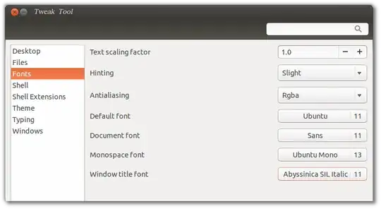

I would suggest you use gnome-tweak-tool Install gnome-tweak-tool to change the title bar font. As of this writing, it works just fine for me.
gnome-tweak-tool
To install gnome-tweak-tool, run this command:
sudo apt-get install gnome-tweak-tool
