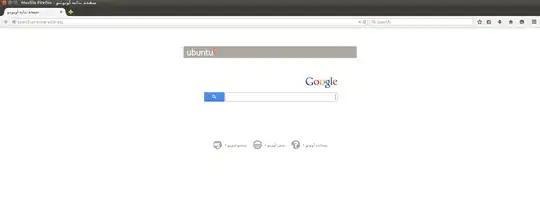

I am getting an ongoing issue with Firefox 36.0 under Ubuntu 15.04.
Whenever I open Firefox it automatically sets the default language to Arabic, even though having never configured it to use Arabic:

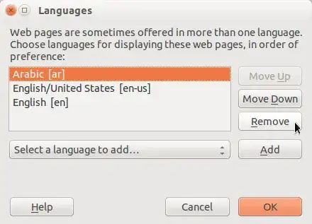

Go to Edit -> Preferences -> Contents tab and click the Choose... button to see the preferred languages. You can remove Arabic or Move Down to make it less preferred.
Content Languages
As you can see on the upper part of the window, this setting is for displaying web pages offered in more than one language. So it have nothing to do with browser language nor with any locales.
