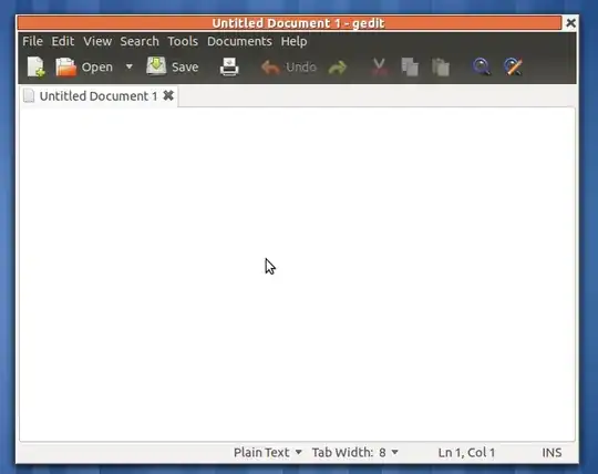

I've upgraded from 11.04 to 11.10 beta and installed Gnome Shell and logged on with the Gnome Shell session. My window title bars are orange like this:
Any way to fix?
Any way to fix?
You need to install gnome-tweak-tool and gnome-themes-standard, then use gnome-tweak-tool to change your window border theme to something supported by mutter (such as Adwaita).
If it does not apply immediately, log on and log back in. Also ensure you've installed all the updates.
