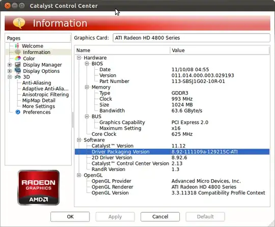

Running Ubuntu 11.10 Oneiric Ocelot, video card HIS Radeon HD4850 11.12 Catalyst, Wine 1.3.36 now.

In CCC (administrative):
-AntiAliansing set to override application setting, 2x
-Adaptive AntiAliansing set to override application setting, performance
-Antisotropic Filtering set to override application setting, 2x
-Mipmap Detail Level set to High Performance
-Vertical Refresh set to 'Always On'
-Catalyst AI enabled, standard
-Tearfree enabled
In Wine:
(1.3.36)
-Windows 7
-On graphics tab evertthing is checked, 800x600 virtual desktop, vertex shader: hardware, pixel shader enabled
-On audio tab all the devices are set manually
Playing with Skype and Pidgin on, and hasn't had crashes for 2 days of quite active playing the same game. Graphics driver is still the latest, catalyst 11.12. Ubuntu 11.10, 64-bit, with the latest updates (+ oneric-proposed).
I guess something changed in CCC helped, you can mark this question as resolved.
