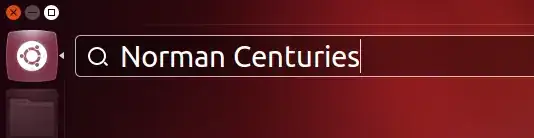

After eyeing Unity's notification APIs for the past few releases, I've developed an itch to write a feed reader that syndicates new arrivals in the Messaging Menu...
Messaging menu
... and provides search in the dash.
Dash image
It would be nice to open the dash straight from the messaging menu, directly to the feed lens searching a selected term. Look at the pictures above to see what I mean.
