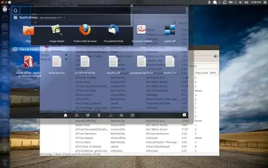

I have a problem: I don't like the blur effect in dash, so I turned it off in ccsm. Before the upgrade, everything was ok, but now dash uses lower part of the screen as a background. It's not correct.
Take a look:
The same thing happens when I hold the Super key.
When I turn on blur, its ok, but launching dash is longer (and I just dont like blur effect).

CCSM options for Dash:
active blur (default) -> performance issues / buggy
static blur -> a workaround to set background https://askubuntu.com/a/79286/
no blur -> currently not possible to change background, no performance issues
For easier tweaking use UnSettings http://www.omgubuntu.co.uk/2012/11/unsettings-a-comprehensive-tweaking-tool-for-unity
