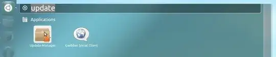

  1. Search for "update" in your dash enter image description here

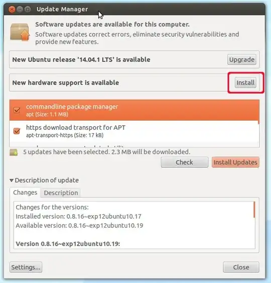

  2. Open the Update Manager and select the "Install" button here (You could upgrade to 14.04.1 as you wish.) enter image description here
If you have your system upgraded to 3.13 kernel, and it's still not working...
This issue should be reported as a bug, please use ubuntu-bug linux command in your terminal to open a bug report on Launchpad.
