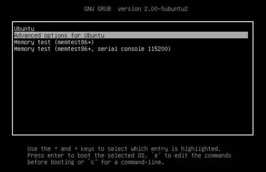

You can find older kernel versions from the grub menu under Advanced options for Ubuntu

If you don't have any older kernel, just install one using
sudo apt install linux-image-5.13.0-35-generic
(the 5.13.0-35 works for me). It seems that next upgrade 5.13.0-41 is a fix.
