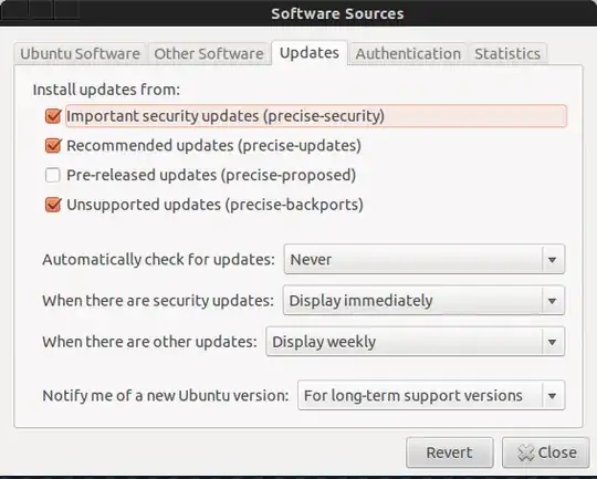

You can set Automatically check for Updates to Never in Software sources or you can access it in Settings option from Ubuntu Software Center.
So when using Wifi or Ethernet you can check for updates manually every-time thus preserving Bandwidth in Mobile Broadband.
