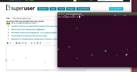

When I started at this job, I had a 12.10 box, with an AMD FirePro V5900. After leaving the computer on for a few weeks, this problem started to show; and it was soon followed by a host of other issues. These other issues (flickering screen, black windows, and more) are out of the question's scope, as they've been documented elsewhere, but from what I can tell, my problem is unique -- several times I have found pictures of what seems to be other instances of the issue, but closer study (loading the page on another computer) indicates that the glitches are on my end. What I see, whatever I might be doing on the computer, is this:
two windows open, each has patches of holes revealing some stuff behind
These patches (of 2-pixel tall holes) flicker with every redraw, many of them changing positions. I've spent a month working with IT trying to fix the issue, and so far we have tried (in order):

Ok, seeing you ruled out almost everything,
What about strong electromagnetic interference near the machine?
Possibly also near the power cables, in case they have issued like incomplete connection to ground locally?
You say "everything except the case [is] new" - that could be a hint in this direction, as it's the main function of the case to keep these problems out.
The other component relevant to handling of electromagnetic interference is the power supply. It actually spends lots of it's complexity on providing well-filtered current, as opposed to just strong current.

[Note: I noticed that this solution was already ruled out for the speciffic case at hand (RAM was replaced), but I keep this answer assuming it may be helpful to readers working on similar issues]
To me, that looks very much like a memory problem, assuming things like loose connectors were already checked.
Now, you ruled out the graphics card by changing it, right?
That would leave the main memory of the machine. Could you exchange, or at least test it?
Your note about "glitches appearing stuck to images" for sure sounds even more like a memory problem.
