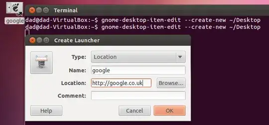

The old GUI dialog is still available if you still want to use this:
Using ALT+F2 type
gnome-desktop-item-edit --create-new ~/Desktop
This will launch the old GUI Dialog and you can create a shortcut on your Desktop:
