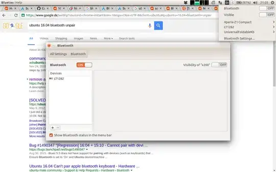

The GUI from the screenshot seems hosed at least to some degree, so use the command line tool bluetoothctl. It is interactive and has a help command.

As can be seen, visibility of a devices in the indicator does not mean that they are all paired or trusted (...so I have no idea what it means to see a device there).
It is also surprising that remove did not work while the Bluetooth controller is off...
