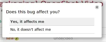

As Danilo Piazzalunga mentioned, the bug is confirmed. As NicDumZ suggested, please vote up this bug by clicking on
Does this Bug affect you?
to raise attention. Thanks!
