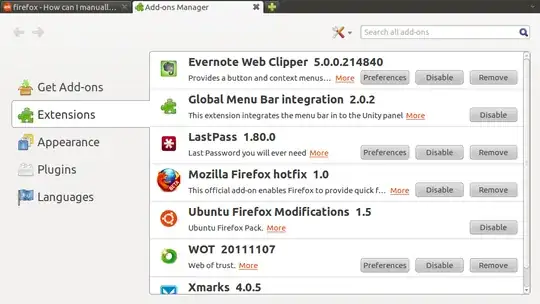

The software centre version of Firefox has Ubuntu Firefox Modifications to enable it to work and integrate with Ubuntu better. The linux version you can download from Mozilla direct does not have this add on so that is likely the reason why you cannot integrate it into the system as you wish.
I guess your option here is to live with what you have or try and install the Ubuntu version and troubleshoot the issues with it.
