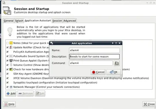

You need to have the program xfwm4 run on startup.
To do that, add a program to the login items.
To add a program to the login items, open up the session editor (Applications Menu > Settings > Session and Startup), switch to the "Application Autostart" tab, and then add a new item:
Click "OK", and you should be good to go.
