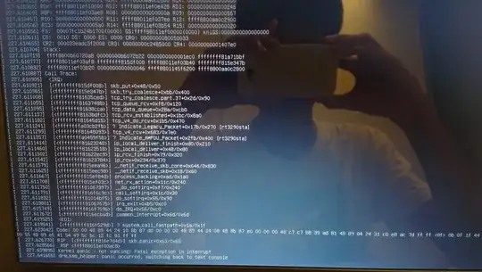

With the "rt2860" module, the Wi-Fi adapter do work at first, but a few minutes later the whole Linux system crash. Error messages I got were:
It mentioned "rt3290sta", and that makes me more confused about whether the driver in use is "rt2860" or "rt3290sta".

Remove the rt2800pci
sudo rmmod rt2800pci
Load the new one
sudo modprobe rt3290sta
Post any error messages.
If the new module, rt3290sta, does not load properly on boot, you will almost certainly need to then black list the rt2800pci module.
