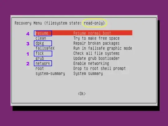

Have you tried booting with RecoveryMode and then attempting to repair you packages? Here's what I think I would do.
  1. Boot to your GRUB boot menu.
    Note: If the GRUB menu does not appear when you boot, hold down the Shift key immediately after the BIOS finishes loading and booting begins. The GRUB menu should appear. If instead you see the Ubuntu logo, then you've gone too far. Try again.
  2. The Grub menu should look something like this:
        Ubuntu, with Linux 3.2.0-23-generic
        Ubuntu, with Linux 3.2.0-23-generic (recovery mode)
        Memory test (memtest86+)
        Memory test (memtest86+, serial console 115200)
    Select the (recovery mode) GRUB menu item and press enter.
  3. You should eventually see the RecoveryMode menu (image below).
    Ubuntu RecoveryMode menu
Now perform the following steps ...
  1. Select & run the fsck entry in the Recovery Menu.
    When you boot into RecoveryMode the filesystem in your root (/) partition is mounted as read-only as a safety measure. If fsck completes successfully, your install partition will be remounted as read/write allowing you to make changes.
  2. Select & run the network menu entry.
    This should enable you to access the Internet and download updates during the next step.
  3. Select & run the dpkg menu entry.
    This will examine the software packages on your system. If a problem is found, it will attempt to repair them if it can.
  4. When the processing for dpkg has completed you can resume booting. However, you may need to reboot for your graphics drivers to be properly initialized.
