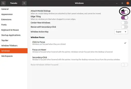

This is not a problem with your system. This is how it works by default. Modal dialogs (e.g. a file dialog) are attached to their parent window and cannot be moved. The parent window is darkened. Parent window and the dialog are moved together. This gives a visual hint that you need to cope first with the dialog before being able to continue working.
Fortunately, this behaviour can be turned off with the following command
gsettings set org.gnome.mutter attach-modal-dialogs false
The setting is also exposed in Gnome Tweaks (not installed by default) on the Windows tab ("Attach Modal Dialogs").
