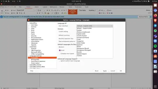

Installing latest candidate snap package of Libreoffice (latest/candidate 7.2.4.1) within Ubuntu 20.04.3 LTS doesn't show many languages, e.g. Hebrew

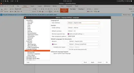

snap 7.2.4.1 - no hebrew enter image description here
When installing the Flatpak version (7.2.4.1) or even the legacy Ubuntu-focal repo version (1:6.4.7-0ubuntu0.20.04.2) Hebrew locale is supported and shown.
Flatpak latest shows Hebrew locale
Please add Hebrew locale to the snap versions.
