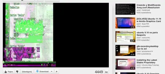

a few days ago I install nvidia xserver because I have a monitor (DELE207WFP) with was saw with maximum resolution 1024x740, and I read that on xserver is possible to write own monitor configuration. I write that driver with tutorial: http://ubuntuforums.org/showpost.php?p=12937, and this works (but a shape are little blurred). I restarted my computer and than when i go to youtube i can see any video
I now I don't know how to do with this, my only idea is to uninstall xserver, but i need it to use monitor, without nvidia driver the screen size is 1024 rather than 1650 and This makes it impossible to work.

Try this to get the very latest driver from nvidia
Add the PPA for nvidia
sudo apt-add-repository ppa:ubuntu-x-swat/x-updates
Update software sources
sudo apt-get update
Download the driver
sudo apt-get dist-upgrade
Then reboot
This fixes many nvidia issues so may help you
