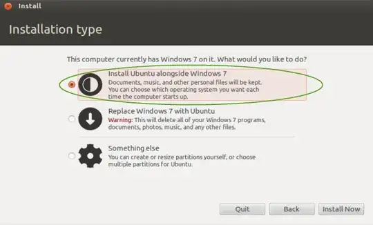

    The install should offer to install Ubuntu "alongside" Windows. This is what I suggest you do. The image below is an example of what the "Installation Type" window looks like. (Though in your case I expect it will be Win XP, not Win 7).
    example of 12.04 install choice
