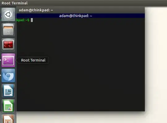

I installed Terminator and made it my default terminal with this solution, but now Ctrl-Alt-T opens Terminator as a root terminal. How do I get it to open Terminator as a normal terminal?

TL;DR #1: Basically, you spawn x-terminal-emulator and Unity searches for anything that has x-terminal-emulator in their shortcut file.
  1. You press Ctrl+Alt+T, which spawns x-terminal-emulator. In Debian Alternatives system, x-terminal-emulator is a symlink to a whatever terminal emulator app you would want to use.
  2. Unity's mechanisms search through the list of "shortcut" files in /usr/share/applications. It finds the gksu.desktop file, which has Exec=gksu /usr/bin/x-terminal-emulator line and then takes out the line Name=Root Terminal. That Root Terminal is then displayed on the Unity's panel
Why the same thing doesn't happen with gnome-terminal?
TL;DR #2: gnome-terminal is actually spawned by a wrapper script, to which the default shortcut is linked.
When you run sudo update-alternatives --config x-terminal-emulator you are presented with choices, but none of them is /usr/bin/gnome-terminal. Rather you have /usr/bin/gnome-terminal.wrapper which is a perl script that sets up gnome-terminal first ! If you read through that script, at the end it has the following line :
exec('gnome-terminal',@args);
The exec call then spawns /usr/bin/gnome-terminal , as separate app. Unity again searches /usr/share/applications/ directory and finds gnome-terminal.desktop file which has Name=Terminal line, and it shows it on the launcher.
