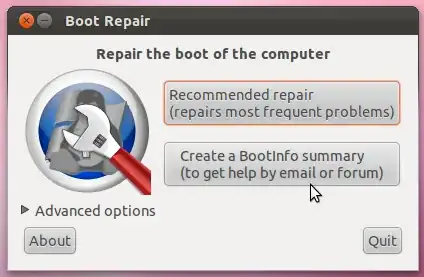

Boot from a live Ubuntu USB pendrive or CD and
Install Boot-Repair on ubuntu by following steps
Open the terminal and run the following commands
sudo add-apt-repository ppa:yannubuntu/boot-repair
sudo apt-get update
sudo apt-get install boot-repair
After completing the installation you can launch it from System->Administration->Boot-Repair menu if you use Gnome, or search "boot-repair" in the dash if you use Unity. Then follow the following screenshots:

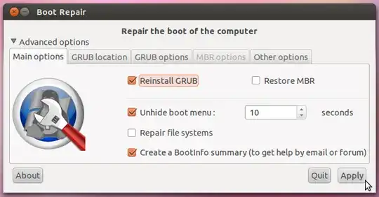

Method 1
  • Click on the advanced options
Initial screen
  • Tick the options shown below
advanced option

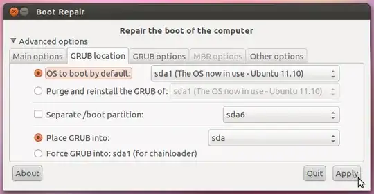

  • Change the tab to Grub Location Tab and Tick The options Shown in the figure
Press Apply and Reboot the system

  • Select the recommended Boot repair options as shown in the first screenshot

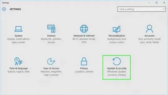

Scott Severance's answer is valid and detailed but there is a resolution that requires no external boot device and so no need to identify and manually mount all of your Ubuntu partitions leading up to the chroot.
In Windows 10, you can use Advanced Recovery to select a device (partition?) to boot from.
Go to Settings and choose Update & Security:

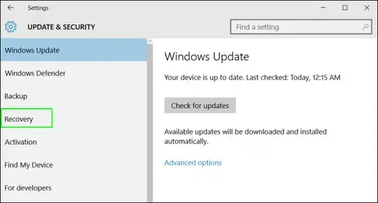

Go to Recovery:
